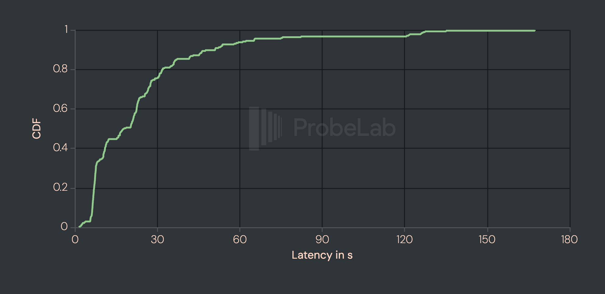

The graph below shows the cumulative distribution function of the total duration of provide operations from Europe, the traditionally fastest region. The original graph can be found here (opens new window). The graph shows that the median latency is around ~20s and that in the worst cases a single provide operation can take over two minutes.
CDF chart of IPFS DHT publish latency (0–180 s). ~30% of publishes complete within 5s, ~80% within 20s, and ~95% within 60s, with a long tail reaching up to 180s.

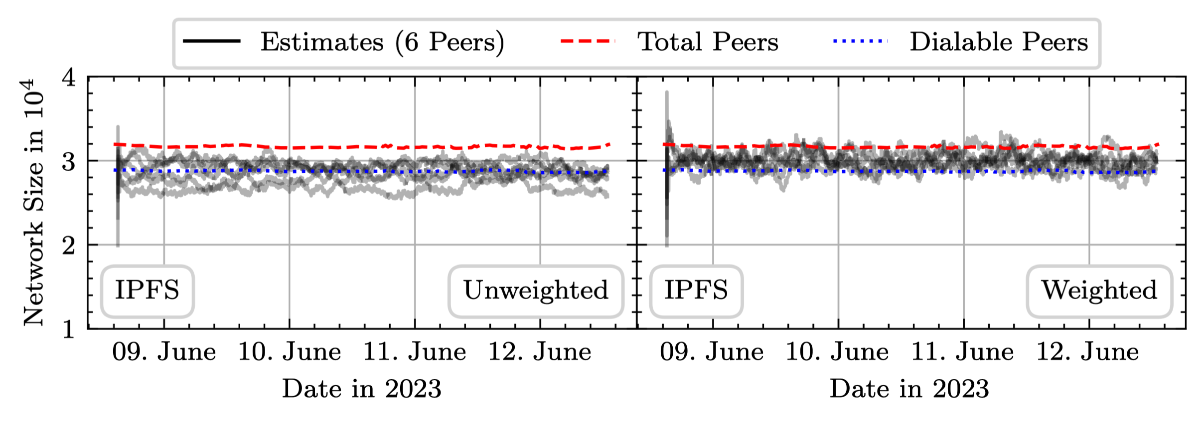

The graph below shows unweighted versus weighted network size estimates from six independent peers in the IPFS Amino network over three consecutive days, overlaid with the total and dialable peer counts from our Nebula crawler.
Two time-series charts showing IPFS network size estimates (June 9–12, 2023) using unweighted and weighted methods. All estimates remain stable at roughly 28,000–32,000 nodes throughout the period where the weighted graph show less variance.

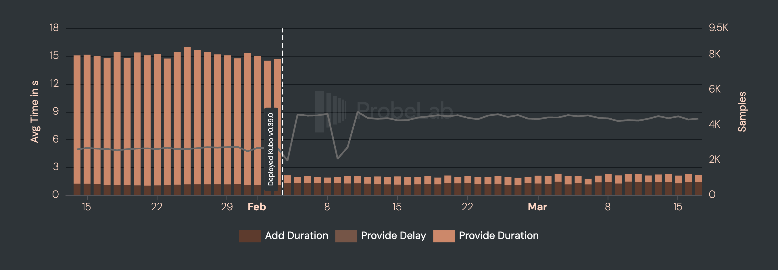

ProbeLab has been monitoring the IPFS Kubo "Upload" performance among many other metrics (opens new window) for a long time through our extensive tooling (opens new window). We have updated our Kubo version to v0.39.0 in the beginning of February. The following plot shows the sharp drop of the upload latency from an average of ~15s to ~0.7s right after the deployment of Kubo that includes Optimistic Provide.
Bar chart showing Kubo "upload" performance (avg time in seconds) from mid-January to mid-March 2026. After deploying Kubo v0.39.0 in early February, provide duration dropped dramatically from ~15s to ~1s.

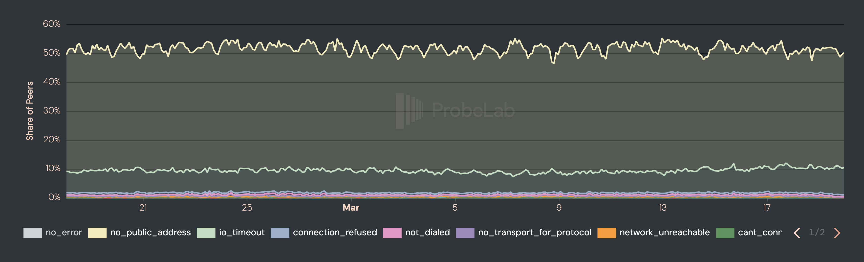

One growing challenge here is the rise of undialable peers in the IPFS Amino DHT. As the graph below shows, roughly 50% of peer identities currently found in the network advertise only private IP addresses and cannot be reached from the public internet. In the current implementation these peers still feed into the network size estimation, inflating the count. This causes an overestimation, which makes the termination threshold more conservative rather than more aggressive. The failure mode is reduced performance rather than broken availability, but it does mean the optimization cannot fully reach its potential.
Time-series chart of IPFS dial error types (share of peers) from late February to mid-March. The error type no_public_ip_addresses dominates at ~50%, while io_timeout holds steady at ~9%. All other error types remain near 0% throughout.

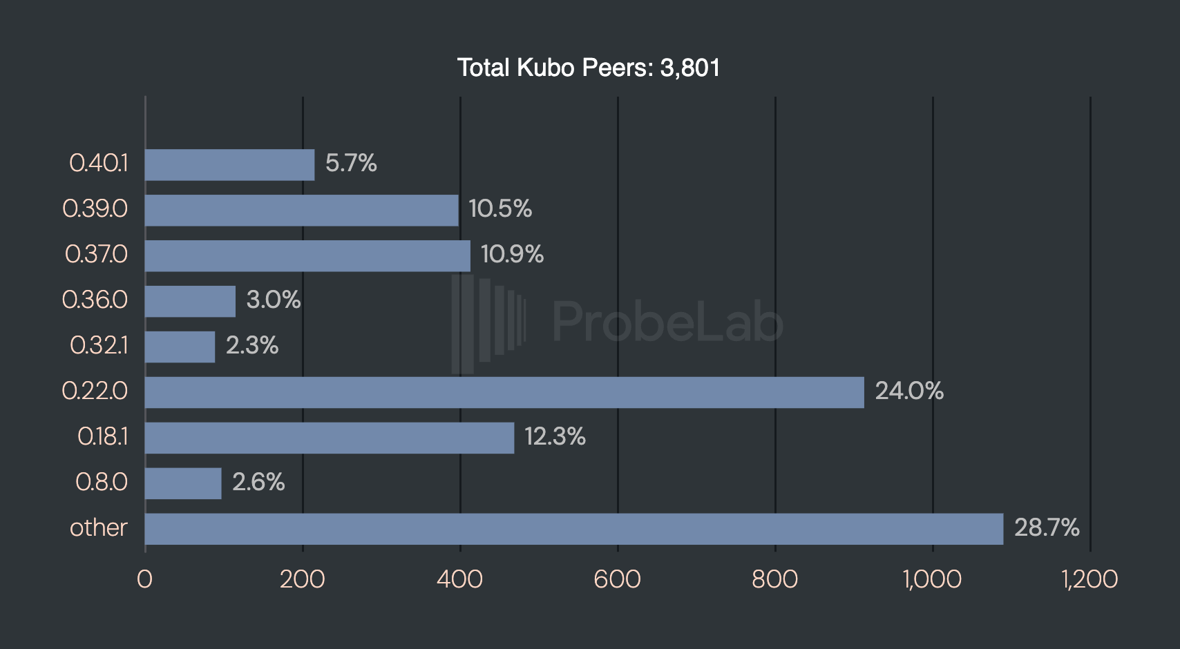

The most immediate action is straightforward: if you are running a Kubo deployment, update to v0.39.0 or later. As the snapshot below shows, only around 17% of publicly reachable Kubo nodes (opens new window) are currently running a version with Optimistic Provide enabled by default — meaning the majority of the network is still paying the full cost of the classic PUT operation (snapshot from 2026-03-20).
Bar chart of Kubo peer versions across 3,801 total peers. Recent versions v0.39.0 and v0.40.1 account for ~17%, while the majority of peers run older versions — led by v0.22.0 (24%) and "other" (28.7%).
