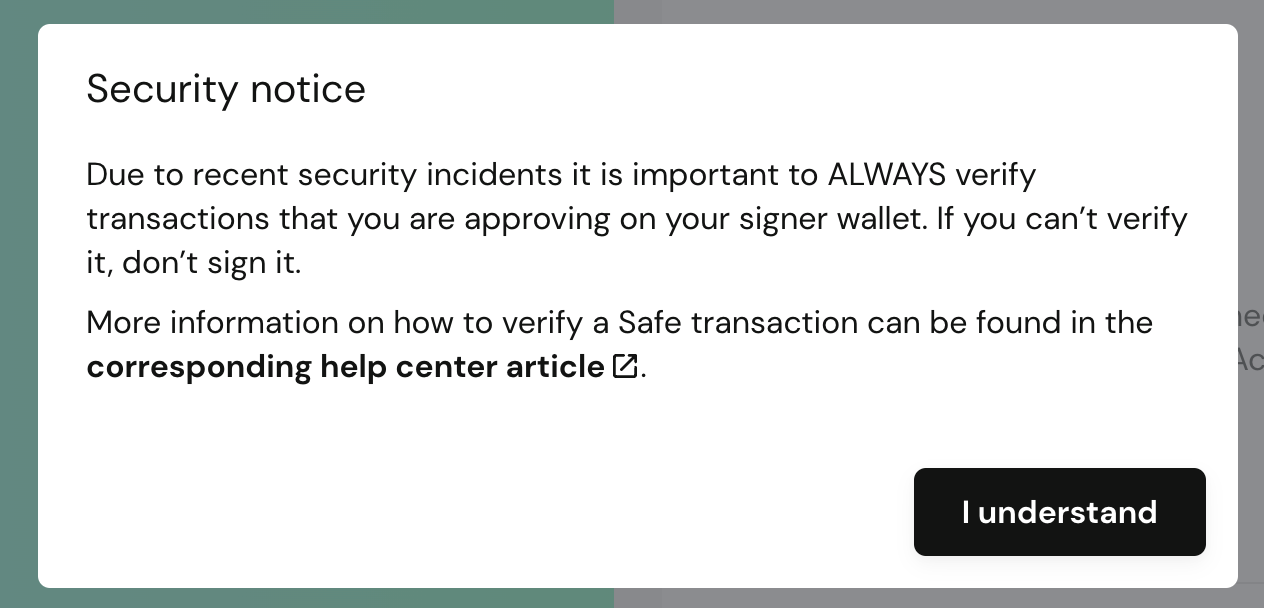

- The Safe multisig owners signed a malicious transaction
- There were no additional approval layers in the Safe smart contract to prevent the malicious transaction from going through.
Since IPFS is mainly concerned with the first point (ability to verify data by means of content-addressing (opens new window)), we'll focus on that. The other two points bring up broader ecosystem needs like clear signing (rather than the blind signing often seen across smart contract wallets), improved UX that strengthens security rather than working against it, and more effective tools for verifying transactions.
The Ethereum community responded quickly, addressing the second point and released multiple (opens new window) tools (opens new window) and documentation (opens new window) to help users verify transactions before signing them.

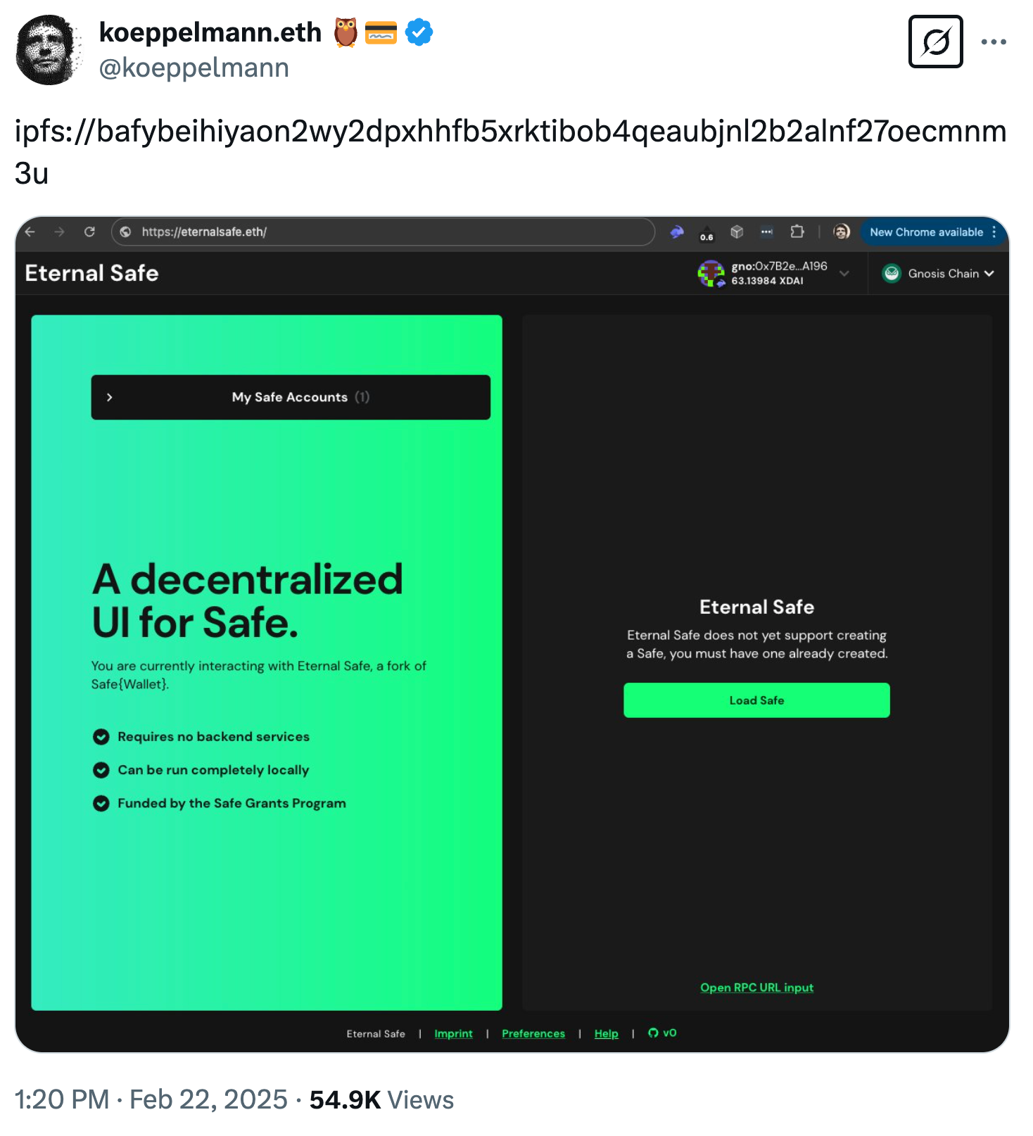

In fact, we feel somewhat vindicated seeing the Gnosis founder share the CID of an open-source fork of the Safe frontend called Eternal Safe (opens new window) shortly after the hack, while the Safe team conducted a forensic review of their services and frontend:
